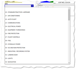

Hi, I'm using ARAS R19. The drop down fields (linked to a list) are very poor and difficult to use on big list. Indeed, on the following list: The user is not able to start to enter "ELEC" to quickly find the expected line. The completion works well but only on the start of the string, not on the middle of the string. Do you know how to enable autocomplete on the middle for all DropDown fields ? Is there a way to "replace" the default dropdown list by a more advanced one (like this one https://harvesthq.github.io/chosen/) ?801Views0likes2CommentsIs it possible to have a 3 stage filtered list?
