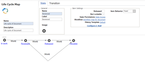

Dear community, I am having problems with the promotions of my item type "Documents". Document is an item type which aims at regrouping various documents of our company. A Lifecycle has been created to describe the different states of these documents: As you can see on the picture above, a workflow has been assigned to this lifecycle. Under the "promotions" tab of the workflow I added the transition states relative to the lifecycle: However, once I go to "my InBasket" and complete the task as "Reviewed", the Lifecycle state remains in the "In work" state. How can I manage to get the "Review" state once I reviewed the task? Thanks in advance for your help! Florian7.2KViews0likes2Comments
