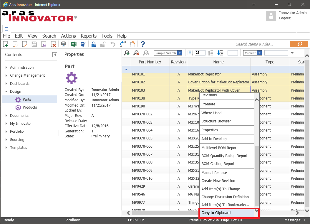

This project contains sample code to demonstrate how to copy text to the clipboard in an Aras client-side action and how to use PE_GetSelectedItems to execute an action on multiple selected items in the Aras Innovator client.
Note: The sample method was developed using the Part ItemType, but can be easily adapted for any ItemType.
