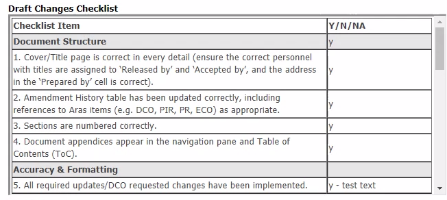

I have a checklist (for users to fill out) in the form of a table as illustrated here:
It is a HTML table housed in a Formatted Text field. I would like to prevent users from modifying the checklist items (first column of the table) or perform some sort of validation of the checklist items to ensure that they haven't be deformed.
Having the items and the entries in a different field (and then disabling editing of the items field) is not an option as the list requires scrolling, and that would cause the items and entries to become misaligned.
Is there a way to achieve what I'm trying to do?

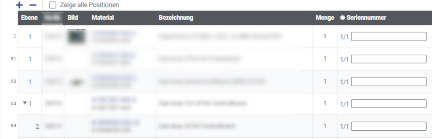

    In stead of using formatted text, you can also create a complete custom html table. This is something that I use:

      This looks really great and is a good idea. I tried something similar, however, I was unable to save user input in the input boxes. What do you use for the input fields? And how do you save the input?
        Regarding Formatted Text you can use "contenteditable":
        It´s not a super reliable solution, user can still change the native html code.
        In my image the table itself is rendered on demand and represents a individual product. User scan numbers into the input fields. The values are automatically stored in an external table. It´s not fully comparable to your use case.
