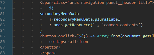

  • NOTE: Open a TOC item, such as "Documents", and then:
    document.getElementsByClassName('aras-nav__parent aras-nav__parent_expanded')[0].classList.remove('aras-nav__parent_expanded')
  • Well, while this works it doesn't seem to update whatever dojo has in memory. It's "Brute force" of sorts.
    onclick="${() => Array.from(document.getElementsByClassName('aras-nav__parent aras-nav__parent_expanded')).forEach(e => e.classList.remove('aras-nav__parent_expanded'))}"
