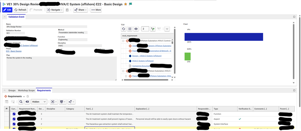

I'm making a relationship grid event that fires on a row selection.  It's meant to target an HTML control on the top item form and then will fill it with a TGV.
Trouble is, I'm running in circles trying to target the element on the form, which is called 'tgv'.
Lots of debugger tries in the console and methods and nothing is finding it.

    Can you provide a rough screenshot? You can hide the actual data!

      Hey Angela, sure thing let me give a screen shot (identifiable info blanked out):
      Basically if a user selects a row in the bottom I'm wanting to refresh/re-run the TGV in the top form.  I can get a specific TGV to display in a dialog, but for whatever reason I can't figure out how to target the top form divs by ID or name from the relationship grid method.
      We're more or less looking to invoke sort of a split view wherein we can get additional details and have people do work in the grid at the bottom without extra clicks.
      I'm not 100% certain that this will be the way to go as the onSelect event seems to fire EVERY click on a row which is not ideal (e.g. when you go to edit, it's firing...) so I may need to approach another way, but conceptually this is what we were aiming for.
