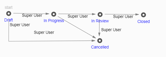

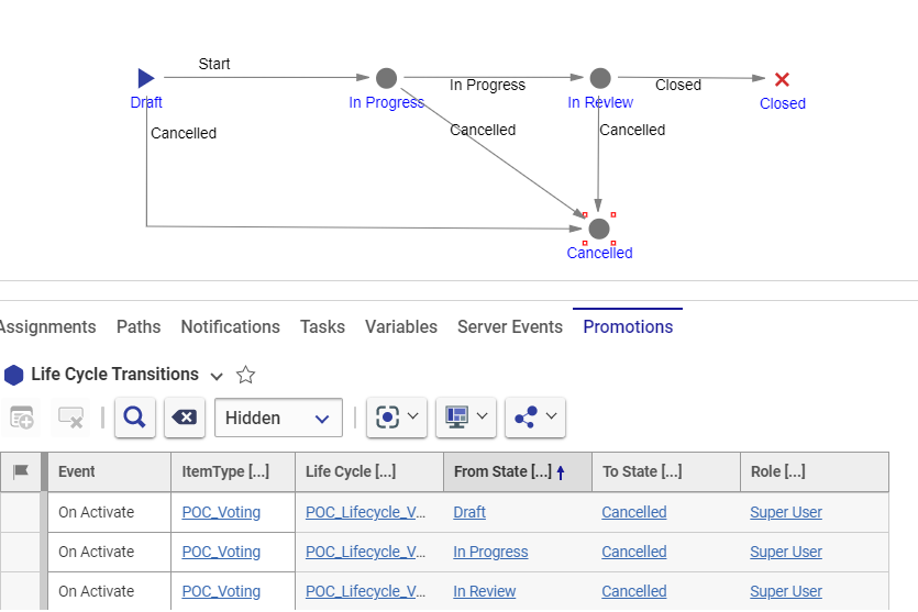

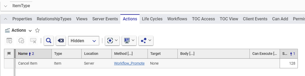

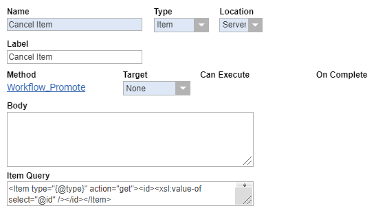

    Create a Server Action and attach to the item type you want this action
    Create a Transition to Cancel State in Life Cycle
    Create a Path to Cancel State and Update the Promotion in Each State in Workflow
    Demo below. 3 items are in different state (Draft, In Progress and In Review) and Action is allowing to Cancel it.
