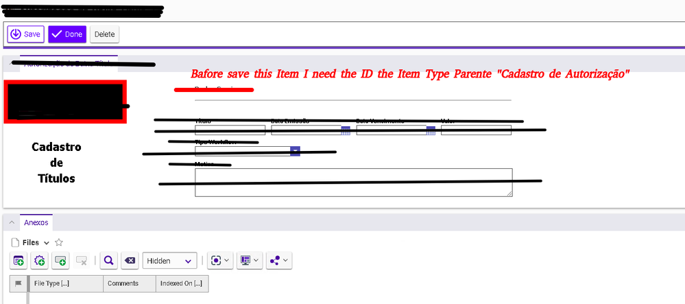

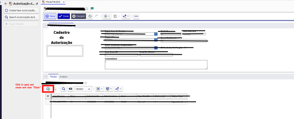

Hello, I have two forms one to insert new "Authorization" this below picture, and when I click in the in the button plus the new form is opened, to insert the new "AuthorizationTittle" second picture, and the issue is that I need the Authorization ID before save the AuthorizationTittle, second form.
Thanks.
- angela4 years agoCatalyst II
Much better! [emoticon:c4563cd7d5574777a71c318021cbbcc8]
If your related item would be just a null-relationship things would be easy, cause you simply use the "source_id" property in your form.
If you have a related item with a relationship in between, things get more complicated. Problem: You can have more then one parent items.
Do you really need your mentioned "Authorization ID", or do you just search for a backlink option?
For viewing parent items the classical approach would be to use some kind of "Where Used / Parent items" tab with a TreeGridView that displays all parents of the item. For example ItemType "Manufacturer" uses this approach.
A custom html field in the Form that shows the ids or source elements itself would also be possible, but requires much more programming.
