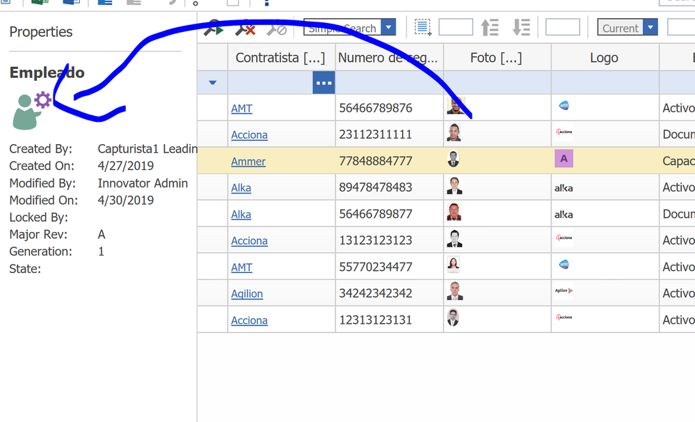

How to upload a photo?
Hello
I hope you can help me, I need this image to upload, which is the employee identification photo, to be loaded where the ItemType logo is,
How could I make this possible?

  • When you change the name of your property from "foto" to "thumbnail", your photo will be displayed like the regulra Part thumbnails below the State: in the properties pane.

  • I'm not saying it's clever, but I think it may be possible by 'tricking' the function Aras.prototype.uiShowItemInFrameEx found in ui_methodsEx.js on the server ../client/javascript into returning your preferred Picture instead of the ItemTypes 'Large Icon'.
    It may be possible to do by changing the javascript method or by modifying the 'ItemType' Itemtype or federating the Icon Property.
    Note, I believe this is being removed in Version 12.
