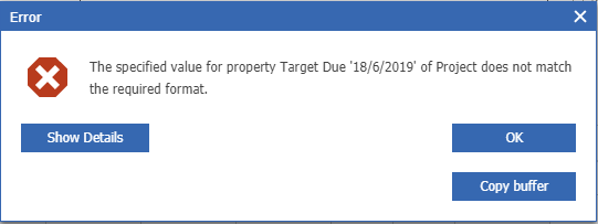

On click of saving project it give following error
I am not getting which format is required.

  • Hi Tushar,
    I've looked at some existing project data to determine the proper format of a date property within Innovator. It would appear that we store a date/time value which looks like yyyy-mm-dd (Time). Here is a screenshot showing what the data looks like in SQL.
    Please try modifying your method to format the dates to this format.

      Yes you are right AJ, aras store date time in yyyy-mm-dd HH:MM:SS this format. I was using dd/MM/yyyy and in that if date or month is less than 10 than it was using single digit i.e. d/M/yyyy. But now I modified my code and just using date yyyy/MM/dd format and its working.
