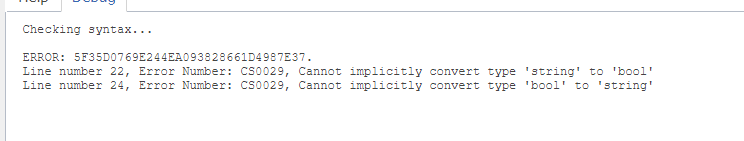

I have this action which runs fine on an itemtype1, I want to use the same action to be triggered when i am on another itemtype2 but itemtype1 is in a relationship.
Currently im getting an error when i click that action from the relationship,

      Im still getting error i added my code in your code below is that
      The action basically help triggers a workflow on an action, It works fine when i do it on an item type but it has issues when i do it on a relationship grid
