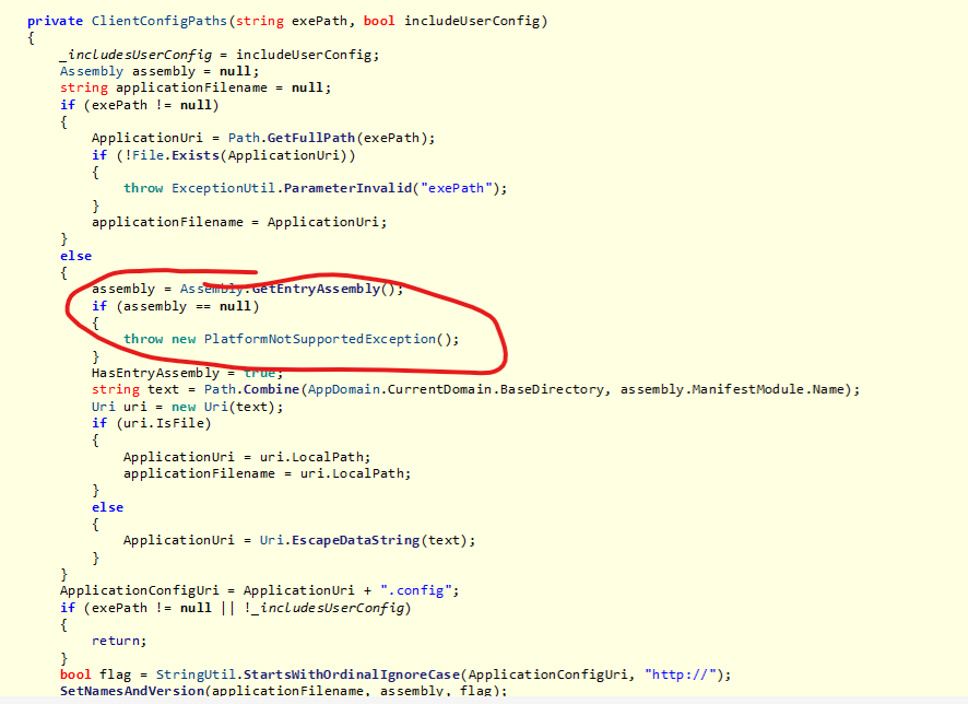

How to load aras 2023 dll with cpp host cli without native net core?
[embed:dc8ab71f-3b98-42d9-b0f6-e21e02a0f8e2:4aacaea8-0c4c-471c-aefc-402fbf171d8a:type=text&text=%23using%20%22C%3A%2Ftemp%2Faras2023dlls%2Fbin%2FIOM.dll%22%0D%0A%23using%20%22C%3A%2Ftemp%2Faras2023dlls%2Fbin%2FSystem.Configuration.ConfigurationManager.dll%22%0D%0A%23using%20%22C%3A%2Ftemp%2Faras2023dlls%2Fbin%2FAras.Net.dll%22%0D%0A%0D%0Ausing%20namespace%20System%3B%0D%0Ausing%20namespace%20System%3A%3AIO%3B%0D%0Ausing%20namespace%20System%3A%3AReflection%3B%0D%0Ausing%20namespace%20System%3A%3AConfiguration%3B%20%20%0D%0A%0D%0A%0D%0Avoid%20arasDo%28%29%0D%0A%7B%0D%0A%20%20%2F%2F%20sample%20aras%20code%0D%0A%20%20System%3A%3AString%20%5E%20url%20%3D%20%22http%3A%2F%2Fdevaras2023%2FInnovatorServer%2FServer%2FInnovatorServer.aspx%22%3B%0D%0A%20%20System%3A%3AString%20%5E%20database%20%3D%20%22InnovatorSolutions%22%3B%0D%0A%20%20System%3A%3AString%20%5E%20user%20%3D%20%22admin%22%3B%0D%0A%20%20System%3A%3AString%20%5E%20password%20%3D%20%22innovator%22%3B%0D%0A%0D%0A%20%0D%0A%20%20auto%20conn%20%3D%20Aras%3A%3AIOM%3A%3AIomFactory%3A%3ACreateHttpServerConnection%28url%2C%20database%2C%20user%2C%20password%29%3B%0D%0A%20%20auto%20result%20%3D%20conn-%3ELogin%28%29%3B%0D%0A%20%20auto%20s%20%3D%20result-%3EToString%28%29%3B%0D%0A%7D%0D%0A%0D%0Astatic%20Assembly%20%5E%0D%0A%20%20LoadFromSameFolder%28Object%20%5E%20sender%2C%20ResolveEventArgs%20%5E%20args%29%20%7B%0D%0A%20%20%20%20String%20%5E%20folderPath%20%3D%20%22C%3A%5C%5Ctemp%5C%5Caras2023dlls%5C%5Cbin%22%3B%0D%0A%20%20%20%20String%20%5E%20assemblyPath%20%3D%20Path%3A%3ACombine%28folderPath%2C%20%28gcnew%20AssemblyName%28args-%3EName%29%29-%3EName%20%2B%20%22.dll%22%29%3B%0D%0A%20%20%20%20if%20%28File%3A%3AExists%28assemblyPath%29%20%3D%3D%20false%29%0D%0A%20%20%20%20%20%20return%20nullptr%3B%0D%0A%20%20%20%20Assembly%20%5E%20assembly%20%3D%20Assembly%3A%3ALoadFrom%28assemblyPath%29%3B%0D%0A%20%20%20%20return%20assembly%3B%0D%0A%20%20%7D%0D%0A%0D%0Avoid%20aras%28%29%0D%0A%7B%0D%0A%20%20%2F%2F%20put%20this%20somewhere%20you%20know%20it%20will%20run%20%28early%2C%20when%20the%20DLL%20gets%20loaded%29%0D%0A%20%20System%3A%3AAppDomain%20%5E%20currentDomain%20%3D%20AppDomain%3A%3ACurrentDomain%3B%0D%0A%20%20currentDomain-%3EAssemblyResolve%20%2B%3D%20gcnew%20ResolveEventHandler%28LoadFromSameFolder%29%3B%0D%0A%20%20arasDo%28%29%3B%0D%0A%7D]
The exePath does not exist
Assembly.GetEntryAssembly() returns a NULL
Can someone explain me how to execute the added cpp sample code so I can load the aras 2023 dlls?

      The solution with COM reference does not function in our case.
      We try to load the aras 2023 dll with CPP/CLI windows exe.
