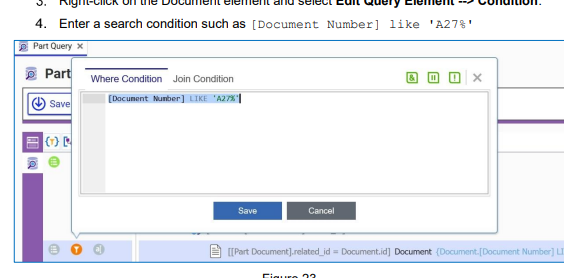

      your second variant should work. Guide says the same:
      Check if your [Part Number] is really called [Part Number]. Maybe you have a custom label?

        The second variant does not work.
        I am going to move to R22 in the next few days and I will try it in that version.
        Thanks for confirming.
