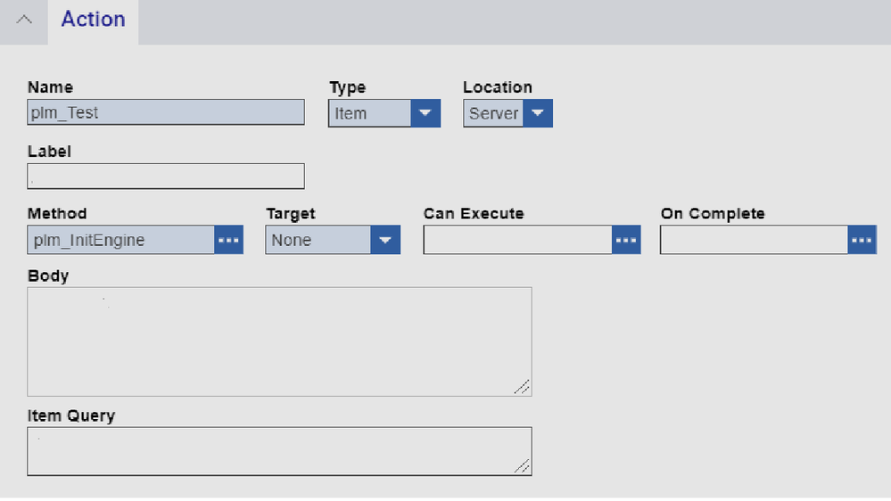

Hi All,
I have Multiple Server Side Item Actions Configured on the Part Item , I want the logic/functionality to be performed by each action to be controlled by the same method .
In which case , is there a way to pass the Invoking action name to the Method so that based on the value I can chose the function to be performed.
For the above action , I want to get the action name "plm_Test" while invoking the method on the Item.
This would greatly help me in avoiding creating Multiple Methods for each Action.
Thanks.

    return inn.newError("This call comes from " + this.getAction());

      Hi Angela,
      Thanks for the response, for some response when I tried this.getAction() it returned the method name and not the Action name.
      I then switched to the CUI menu item and I am now able to get the resp menu button name in the inArgs parameter [emoticon:c4563cd7d5574777a71c318021cbbcc8]
