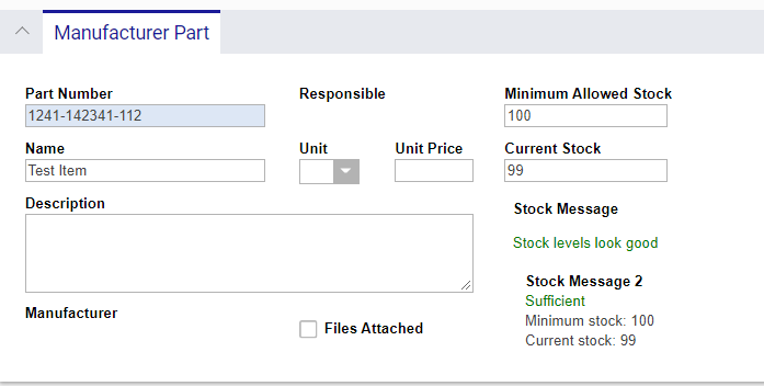

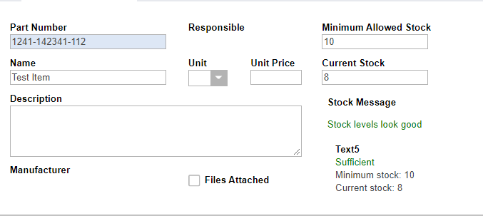

The problem is that it works for a little bit, and then the evaluation does not reflect the correct values.
Some examples:
Any ideas?
Thanks
    Are your fields "string" or "integer" properties? According to your debugger, they look like strings! In this case greater and less may calculate based on wrong values.
    Try to parse the value  -->
    parseInt(minStock, 10)
    And maybe use an onFormPopulated event instead of onLoad, when the fields shall also update when user edit the item.

      • RaptureLazarus's avatar
        RaptureLazarus
        HI Angela, thanks for your suggestion, however I am still stuck.
        I have added the debugger and function call on both the onLoad method and HTML field variants, but I'm still getting the same result.
        I even separated the if function as follows, to try and get a different result:
        [embed:dc8ab71f-3b98-42d9-b0f6-e21e02a0f8e2:cf52f2b7-d8a6-474d-96b9-c6cd5d6029a4:type=text&text=if%28currStock%20%3C%20minStock%29%0D%0A%20%20%20%20%7B%0D%0A%20%20%20%20%20%20%20%20field.innerHTML%20%2B%3D%20%22%3Cp%20style%3D%27color%3A%20red%27%3ENot%20enough%20Stock%21%3C%2Fp%3E%22%3B%0D%0A%20%20%20%20%20%20%20%20return%3B%0D%0A%20%20%20%20%7D%20%0D%0A%20%20%20%20if%28currStock%20%3E%20minStock%29%7B%0D%0A%20%20%20%20%20%20%20%20field.innerHTML%20%2B%3D%20%22%3Cp%20style%3D%27color%3A%20green%27%3EStock%20levels%20look%20good%3C%2Fp%3E%22%3B%0D%0A%20%20%20%20%20%20%20%20return%3B%0D%0A%20%20%20%20%7D]
        The second if statement is triggered every time.
