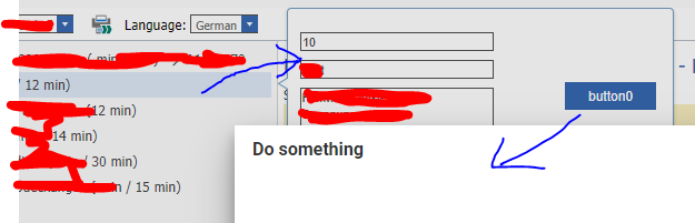

out of interest I made a quick test by myself and it just worked fine. I used a standard Form call:
Setup like this:
Used code:

topWnd.ArasModules.MaximazableDialog.show("iframe", params).promise.then(callback);- angela4 years agoCatalyst II
My previous post referred to a some other use case of mine where I used multiple intersecting dialogs. In this case Innovator mixed up the callbacks cause I had overwritten the top window with another top window. Seems not be a problem here..
