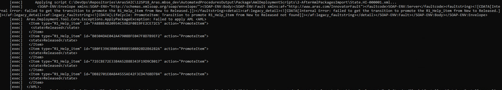

    • Tyler_Kim's avatar
      Tyler_Kim
       Jayrajvh I'm getting a "failed to get the transition to promote the Item from New to Released error:
      Previously, there was no direct transition from New to Released. Do I need to add a transition (with the Aras PLM identity) to make this possible?
      EDIT: I've added a transition from the New to Released state (with the Aras PLM identity) and I'm still getting the same error
      EDIT2: I've also tried moving the item to the very next state (transition handled by a non-admin identity) and also got the same error
