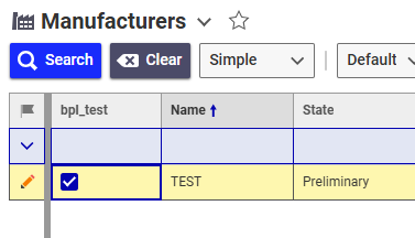

Hello Team,
I have observed that when I try to check a Boolean property value as true from the main search grid window, it does not update correctly. On the server side, we are receiving the value as true instead of 1. Is there any workaround for this?

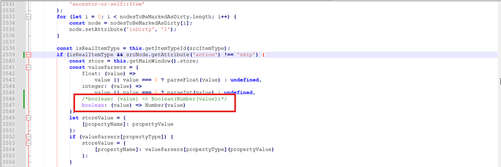

  • Hello,
    I have modified the below change in code tree file Innovator\Client\javascript\aras_object.ts
    Is this right way to fix this issue?
    Regards,
    Suhas

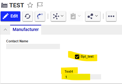

      This is what I tried:
      1. Edit boolean value in search grid:
      2. Check result - Text4 shows the boolean value as string. It´s identical to the value that is stored in the SQL database.

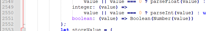

      aras_object.ts looks identical to your shown code! But there are a few elements that are used for the grid logic.

      • Suhas's avatar
        Suhas
        Hello AngelaIp ,
        This property is setting 0 when you click on "done editing" action. Can you please confirm this? I have checked this issue in Aras24, 33 & 35.
