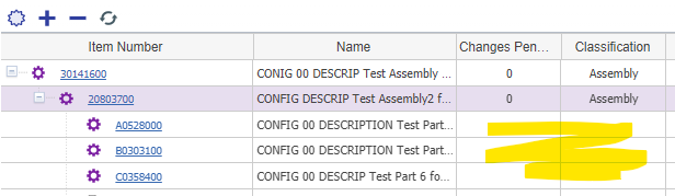

Hi all,
Aside from adding the relevant lines to the  Express ECO ImpactMatrixGrid, is there something else I need to edit to add the columns? My new column is appearing as undefined.

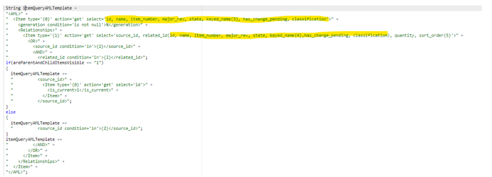

    The highlighted lines in the code below, which starts at line 128, is the AML that determines which properties are pulled into the tables that are referenced in the Express ECO ImpactMatrixGrid method. We will need to add our properties here.
    We will also need to add our property in one more place, where highlighted, beginning at line 266.

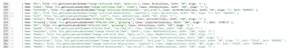

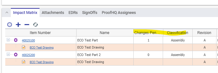

    Now, we can update the Express ECO ImpactMatrixGrid to add our columns. Add a new line to the grid initialization to define the new property as seen below. Per the notes here, I added Changes Pending and Classification.
    To remove an existing column, remove it from the initialization definition. Some columns drive additional functionality, and as such cannot be commented out such as EDR and Grouping without causing the matrix some issues.

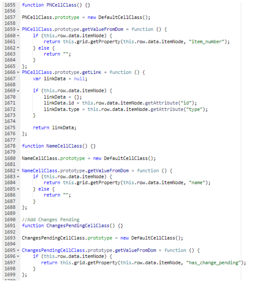

    Next, beginning at line 1655, you will see functions that define the data being pulled into the grid. From here, add a function to setup your properties. Once complete, the new columns and relevant data should be displayed on the Impact Matrix. In the example below are the functions for Part Number and Name along with the added function for the new Changes Pending:

    you mainly have to customize the Method 'Express ECO ImpactMatrixGrid' .
    For addition columns you have to add your properties in block "ImpactMatrixGrid.prototype.initializeGridStructur".
    You need to specify your own "Cell Classes" as seen in available code.

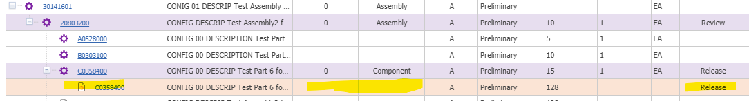

      Success, however now for some reason there is some odd behavior. My columns are there but values are only populating for Part...
      And when adding a sub-assembly, it only populates for the the item I add, and it's parent...
      When I set an action on an item these populate as well.... unless the item in question is a CAD Document

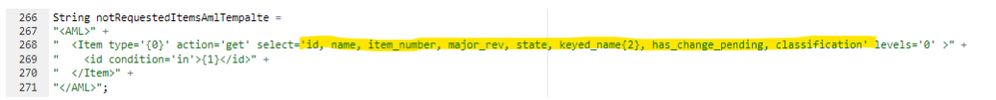

        Got this resolved too. Had to edit 'Express ECO GetDataSource' again -
        At line 266, add properties here as well:
        [embed:dc8ab71f-3b98-42d9-b0f6-e21e02a0f8e2:b8ccce9b-e0bf-4940-b7cc-cf566c4fcfd1:type=text&text=String%20notRequestedItemsAmlTempalte%20%3D%0D%0A%22%3CAML%3E%22%20%2B%0D%0A%22%20%20%3CItem%20type%3D%27%7B0%7D%27%20action%3D%27get%27%20select%3D%27id%2C%20name%2C%20item_number%2C%20major_rev%2C%20state%2C%20keyed_name%7B2%7D%2C%20has_change_pending%2C%20classification%27%20levels%3D%270%27%20%3E%22%20%2B%0D%0A%22%20%20%20%20%3Cid%20condition%3D%27in%27%3E%7B1%7D%3C%2Fid%3E%22%20%2B%20%0D%0A%22%20%20%3C%2FItem%3E%22%20%2B%0D%0A%22%3C%2FAML%3E%22%3B]

      Thanks Angela, I've got it configured with these items and I can now view the column and the name however it is not populating the value.
      I am looking to add the has_change_pending property, which I have added to Change Controlled Item for the purpose of populating the impact matrix (this missing on the item type was causing the undefined).
      Currently, it is always showing blank so that is the next thing I am trying to solve. I am assuming I need to setup my cell class to show a specific value if true so will do that and report back.
