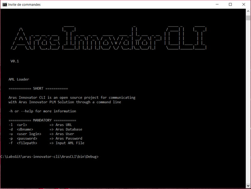

Today it allows you to send the AML content of a file. You execute the exe with the following arguments to connect to the right Aras Instance :
  • URL of the Aras Instance
  • Database name of the Aras Instance
  • Username
  • Password
  • Filepath of the file containing the AML you want to send.
It has now its own Github project, so feel free to fork it, or just suggest additional features.
