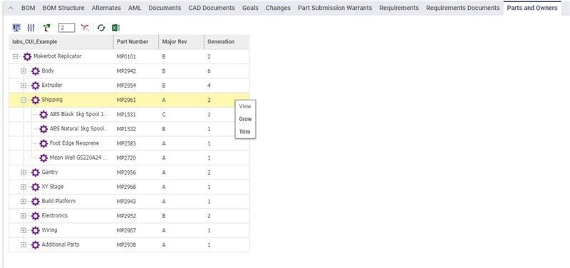

- Next we want to add an option to our context menu. Go back to the Part TGtV Example Presentation Configuration. Where before you opened the toolbar, now open the Context Menu by right clicking it and clicking Open.
- Like the toolbar, this will augment the usual options. Unlike with the toolbar, in most default configurations there aren’t any existing context menu options. In the Command Bar Item view, create a new row. Set its properties as follows:
- ItemType: Menu
- Name: Example_Menu_Option
- Action: Add
- Identity: World
- Right click the new row, and click Open
- Here, we have another set of properties to fill out. Click Edit to change them.
- The Label is what shows on the menu- set this to “Our Example”
- The Init Method is a method that runs when the menu opens. Leave this blank for the moment. This is often used for further precise configuration of when the option is visible: a method which ends with “return {'cui_disabled': true};” will not be available.
- The Click Method is what will happen if we click on it. Set this to a method of your choosing, perhaps a simple alert to confirm that it works.
- Click Done.
- Now our new Tree Grid View has a customized toolbar and a custom context menu.

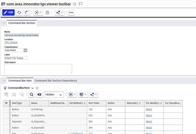

- In the Command Bar Section, look for Location with TGV_ContextMenu and TGV_Toolbar. Right click and then open each of them.
- From here, this should look very familiar to steps five and seven from the first section.
- To change the toolbar, go to TGV_Toolbar.
