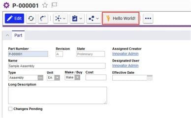

To see our work, open a Part item. You should see your new button in the toolbar up top, right as you see below.

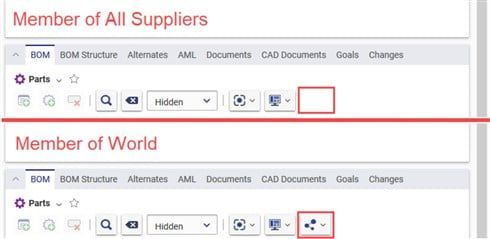

To test this, you’ll want to log out of Aras Innovator or open a new browser. Either way, log in as a member of the All Suppliers identity. Open a Part item to see that the Share button no longer appears in the Part BOM relationship toolbar.

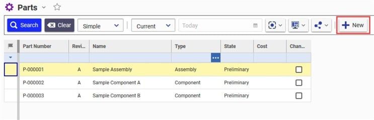

To see your change, open the Table of Contents then navigate to Design -> Parts to see the custom “New” button in the search toolbar. You should see it sitting proudly changed, easily altered and present for all future use. Toolbars are, in the end, a vehicle for the tools we put in them. Adjusting your toolbelt to the task at hand shouldn’t be hard, and in Aras Innovator, it isn’t. You can even add shark repellant!
