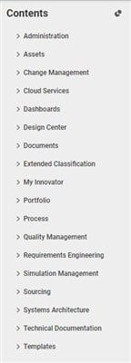

In our example, we’ll change the Design category in the default setup to be Design Center.
  1. In the Table of Contents, go to Administration->Configuration->Client Presentation.
  2. Search Client Presentation, then click the Global property in the result.
  3. In the Command Bar Section grid, right click the com.aras.innovator.cui_default.toc and then click Open.
  4. In the Command Bar Item grid, right click the com.aras.innovator.cui_default.toc_Design and then click Open.
  5. Click Edit.
  6. Change the Label to Design Center.
  7. Click Done.
You may need to log out and back in again, but when you do you’ll see the changed label. Combined with changing the labels on individual items and changing where in the TOC an itemtype shows up, you can freely reorganize the table of contents however you like!
