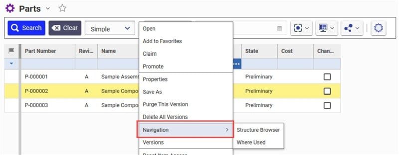

Add a Submenu Item
The ideal menu shows exactly the right array of options. Too few, and we don’t have the tools we need. Too many, and it becomes hard to find the option we want. Fortunately, in the Configurable User Interface we can nest menu options underneath each other, giving us all the tools with none of the clutter. As an example, lets store the Structure Browser and Where Used menu items under a new Navigation section in the main grid context menu. (That is, the menu you see when you right click a part from a search.)

To see your results, open up Parts (or any search grid) and run a basic search, then right click a row. You should see the “Navigation” submenu, and within, the familiar Structure Browser and Where Used options!

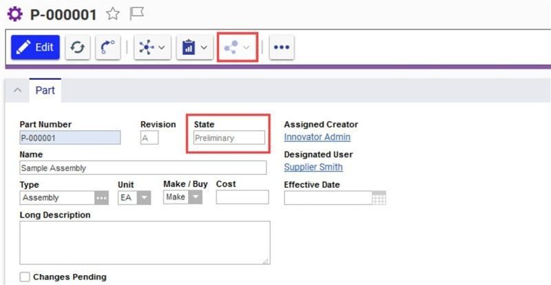

Disable a Menu
Last trick for now: Sometimes, you decide you really don’t want users making use of a certain menu for some reason. It could be that you want to link access to that menu to certain permissions, or to particular steps in the process. In our example, we’re going to disable the Share menu for items that haven’t been released yet.

To see this in action, go to an unreleased item. You should see the Share button is present, but grayed out and disabled.
