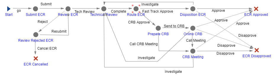

Standard Aras ECR Workflow
Workflows are how work gets done in the Aras system, with activities being assigned to Identities or Team roles for work. Then by having those assignments voted on, delegated, escalated, or otherwise re-assigned to move along the request path, once the work is complete. Workflows should mirror the real life process as much as possible, both for readability, and for completeness. Once a workflow has been started, and items have been created, overriding an active workflow with an updated one would need to be done with care.

  • Diagram the process, maybe even using the Aras workflow interface; a picture is worth a thousand lists. Lists miss activity interactions and even simple things like the ability for a state to have an option to cancel the process.

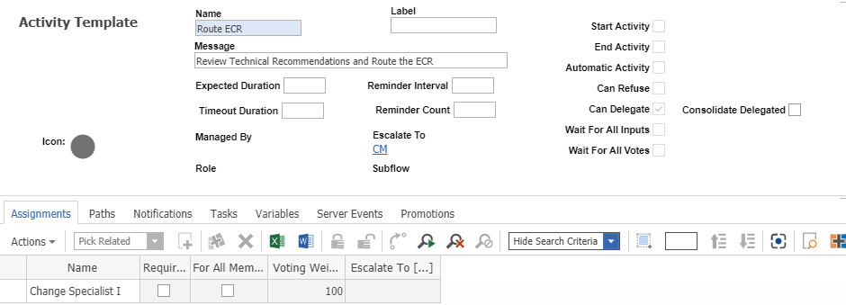

Workflow Activities are the units of work to be done in a process. Your activities need to encompass all possible steps in the process, even the low probability ones. A workflow will also need at least one start and one end activity. Activities can also be flagged as automatic if they do not need any human intervention. With this option set, the voting path set as default will then be followed.
An Activity will also need an Assignment, whether that is set here on the workflow to an identity or team, or left up to the Managed By role to assign ad hoc, somebody needs to be told they have something to do. Automatic activities do not need assignments. You can also distribute the voting weight per assignment. An in-depth discussion of voting weight will occur in a later blog post.

Paths are just that, the lines between activities. These represent the possible voting paths to the next (or previous) step in the process. Paths in Aras can have methods attached to them, and can also be set with an authentication lockout; either to verify the work is complete so users don’t just click through, or to protect an override path like the fast track approve in the example above. Another reason for authentication is an override path: these paths override the voting structure and force the workflow down a specific path, such as cancelling the workflow.

As you can see in the above picture there is much more to an activity that just a name and an assignment. A couple of these are not really optional, but they are outside the original discussion of activities and paths so they end up here.
Activity Settings
