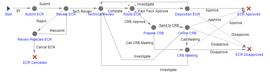

Standard Aras ECR Workflow
Workflows are how work gets done in the Aras system, with activities being assigned to Identities or Team roles for work. Then by having those assignments voted on, delegated, escalated, or otherwise re-assigned to move along the request path, once the work is complete. Workflows should mirror the real life process as much as possible, both for readability, and for completeness. Once a workflow has been started, and items have been created, overriding an active workflow with an updated one would need to be done with care.

  • Diagram the process, maybe even using the Aras workflow interface; a picture is worth a thousand lists. Lists miss activity interactions and even simple things like the ability for a state to have an option to cancel the process.

Paths are just that, the lines between activities. These represent the possible voting paths to the next (or previous) step in the process. Paths in Aras can have methods attached to them, and can also be set with an authentication lockout; either to verify the work is complete so users don’t just click through, or to protect an override path like the fast track approve in the example above. Another reason for authentication is an override path: these paths override the voting structure and force the workflow down a specific path, such as cancelling the workflow.

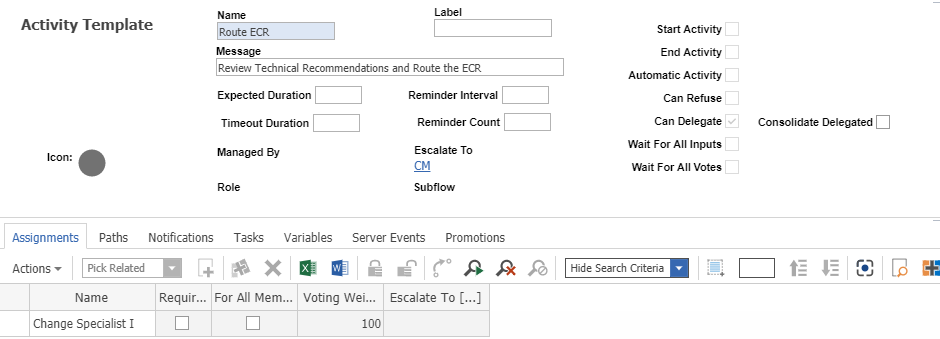

Workflow Settings
As you can see in the above picture there is much more to an activity that just a name and an assignment. A couple of these are not really optional, but they are outside the original discussion of activities and paths so they end up here.
Activity Settings
  • Start and End Activity
    • At least one of each is required for a working workflow. Aras supports multiple start and end activities.
  • Automatic Activity
    • When activity activates, it is automatically voted down the default path, unless directed by an outside method.
  • Remaining Items
    • The delegation, refusal, and wait for all items will be covered further in a future blog post.
