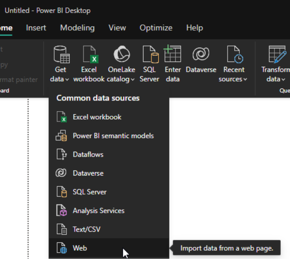

  1. Open Power BI and generate a new report

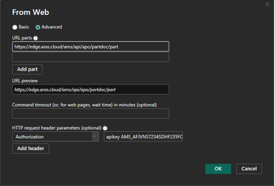

  1. In the Get Data tab, select web source:
  1. Click advanced and input your Edge URL for a specific query. That should look like this: https://edge.aras.cloud/ams/api/{YOUR_INSTANCE}/{YOUR_API}/{ITEMTYPE/QUERY}
  1. Under HTTP Request header parameters, add a header titled Authorization. The value should be apikey {YOUR_API_KEY}

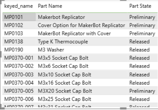

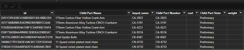

 You should now see all the data your request serviced:
 Repeat the previous steps for any other requests you’d like to make. For the example document, I’ll be adding Documents, Part BOM, and Part Document.

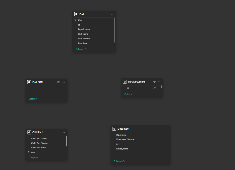

Once you have created your tables, you can then press the Model View button:

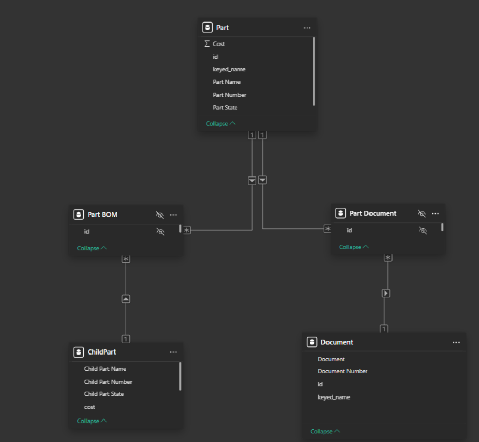

 to open up the following view:

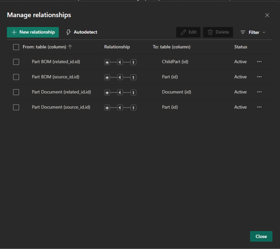

Now all you have to do is click the Manage Relationships button in the toolbar, and you’ll see the following dialog.
From here, you can manually create the connections between your data. Make sure you create connections between relationships, as well as any Item Properties you’ve included. Once you’ve created your connections, your model view should look something like this:

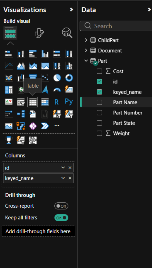

To include your InnovatorEdge data in a visual, open the Report View, and on the right-hand side, you should see the following pane:
This allows you to select the type of visual you’d like to include and the data you want displayed. In this instance, I've created a simple table.

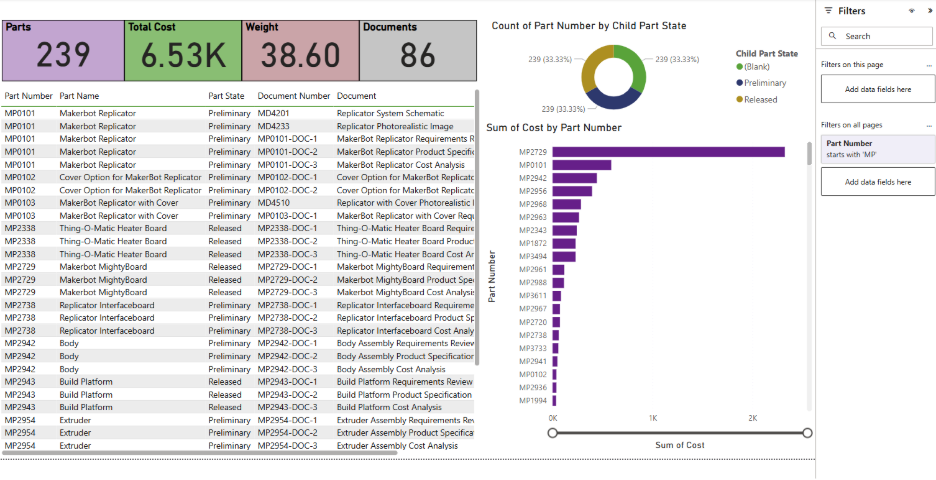

Conclusion
From this point on, you can use your live Innovator data to create powerful, useful visuals.
