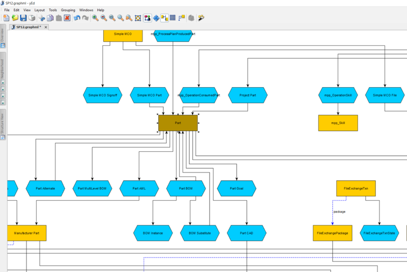

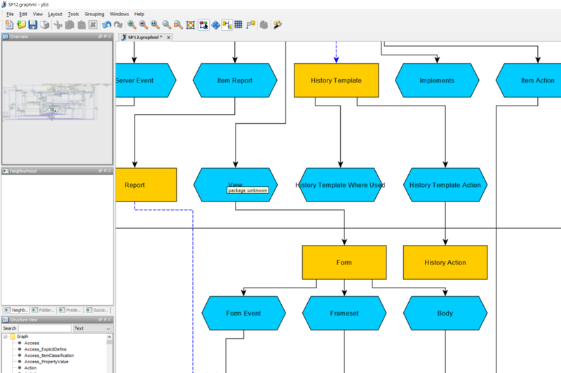

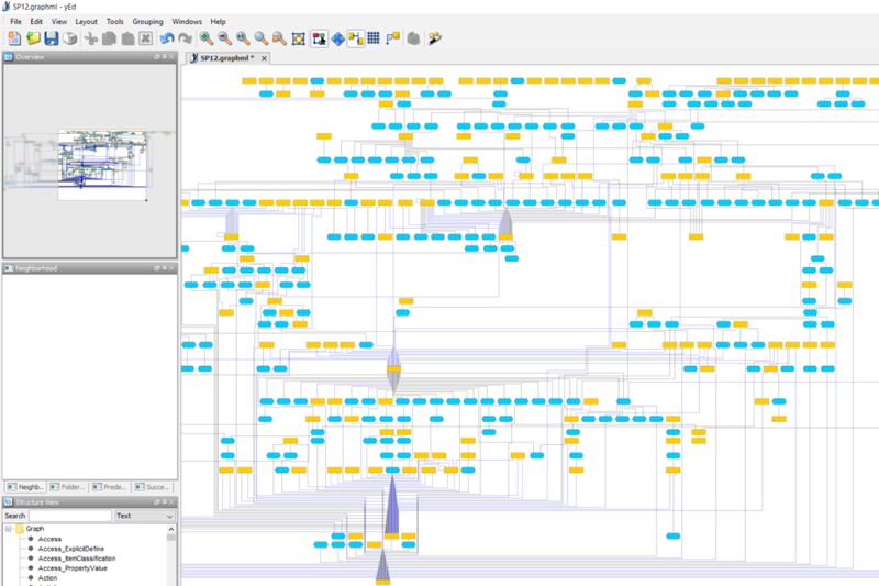

Today I want to a share a script that I wrote recently after being asked by a few customers to export the data model of an Aras Innovator instance because it would help them understanding and being in control of their customized instance.
This script basically queries Aras Innovator using our API (IOM.dll) and looks for ItemTypes, RelationshipTypes, and item properties (I haven't handled the PolyItems yet). It converts the result of these queries into GraphML format. This allows software like yEd to layout a human-readable data model diagram, helping you understand the Aras instance being implemented.
Check out a few screenshots of the results:
