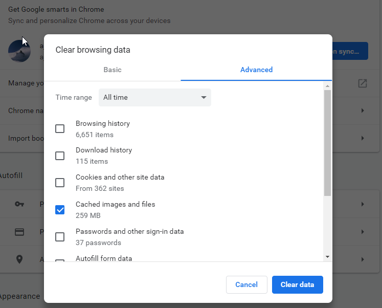

After pasting the new files to this location, you'll need to refresh your client cache before the changes are visible within Innovator. This varies from browser to browser, but in Chrome, CTRL+SHIFT+DELETE will prompt you to clear your client cache.
