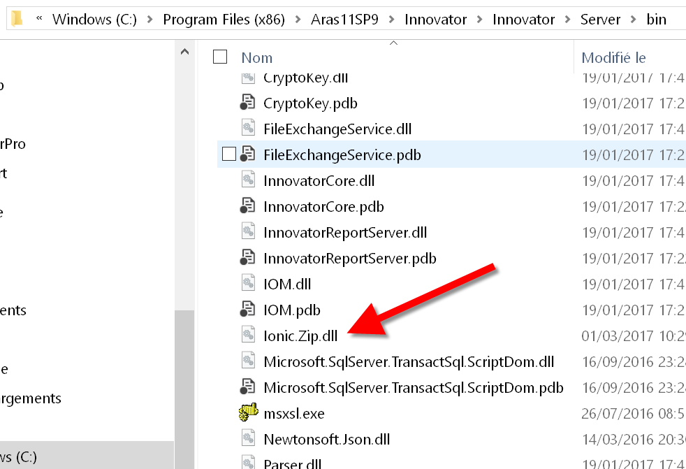

  1. Add your dll to the install bin folder (mine/default for SP9 may be : C:Program Files (x86)Aras11SP9InnovatorInnovatorServerbin)

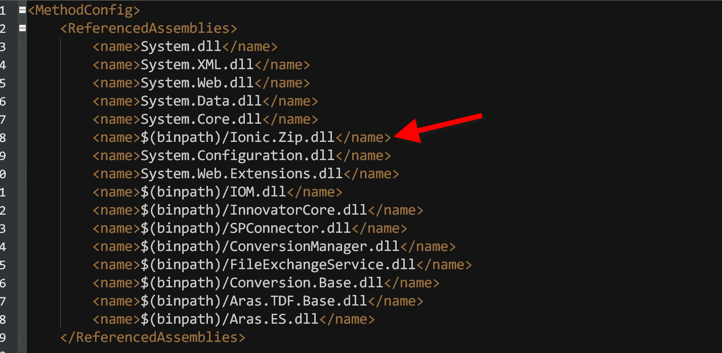

  2. Then you need to edit the method-config.xml file from your Innovator server folder (mine/default for SP9 may be C:Program Files (x86)Aras11SP9InnovatorInnovatorServer)
  3. Add a reference to the imported DLL

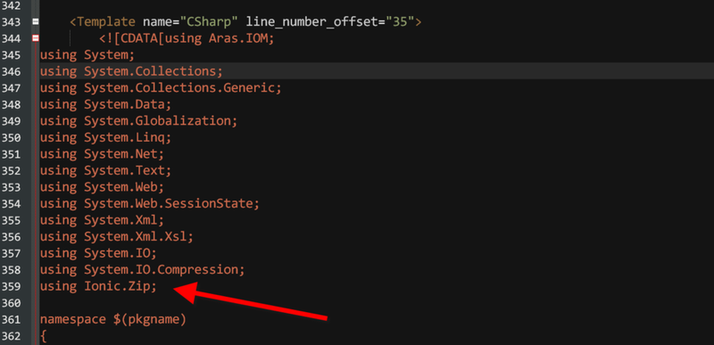

  4. Add the "using" reference in the csharp editor section ("import" for vbscript if you need it)
