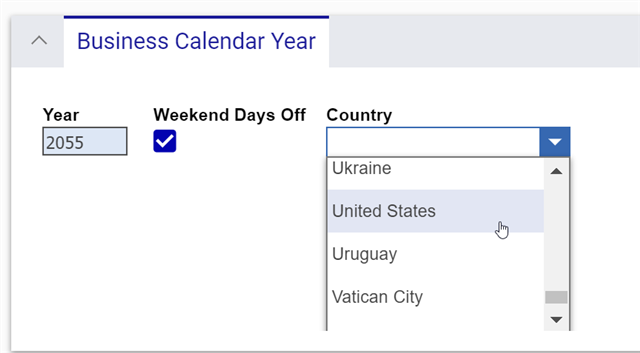

We’ve added an extra property to the business calendar ItemType, “country_code”, as well as an extra field on the business calendar form. The field is populated by a list which contains all 101 countries supported by the Nager API. This form can now supply all the data we need for our API call.

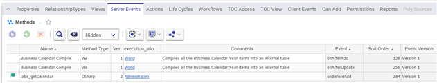

Now that we have all the data we need, we can create a server event to handle interacting with the API and adding the holidays to the newly created calendar. We’ll be adding a new onBeforeAdd server event to the business calendar ItemType. We’ll be using onBeforeAdd as opposed to onAfterAdd because we can cut down on the number of server calls we’ll be performing this way. If we were to add the item and then modify it in an onAfterAdd method, we’d have to perform a server call for both the addition and the modification. By using an onBeforeAdd, we can manipulate the context item before the addition, which will result in a single server call. We can add the necessary relationships to this, before handing it off to the standard add process.
Our method will query the newly created calendar to get the necessary information, year and country code, before handing them off to our external system. Our method will then build a URL which is accessible by REST requests and retrieve any response. Our response will be a list of holidays formatted within a JSON object.
