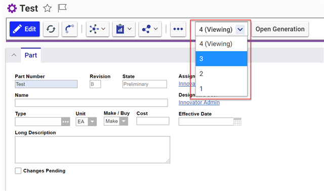

Now we're ready to test it out. If we open up a Part that has multiple generations, we should see that we can select any of the older generations.

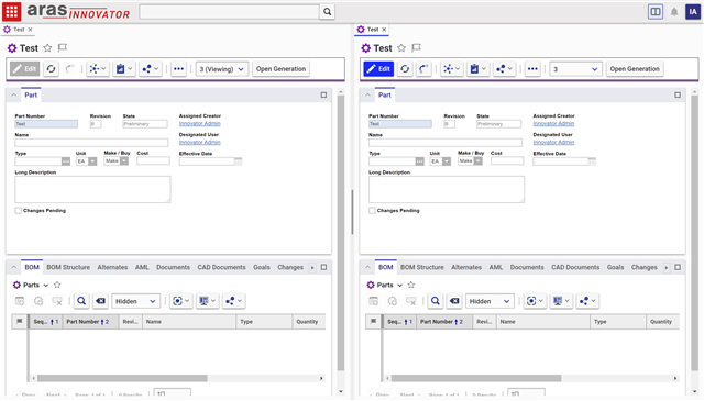

And if we select an older generation and click the Open Generation button, a new window will be opened with the older version of the item loaded into it. We can then click the standard split screen button to compare both generations of the item.
