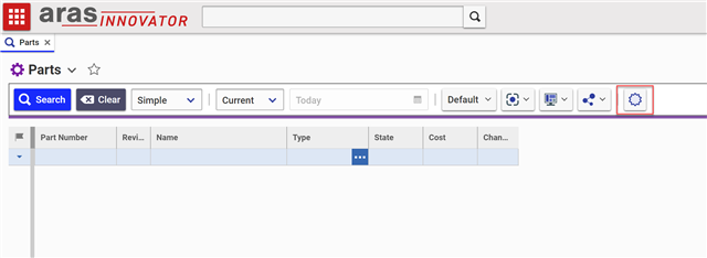

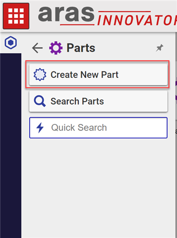

  1. Using a menu button from the TOC
  2. Using a button from the main search grid

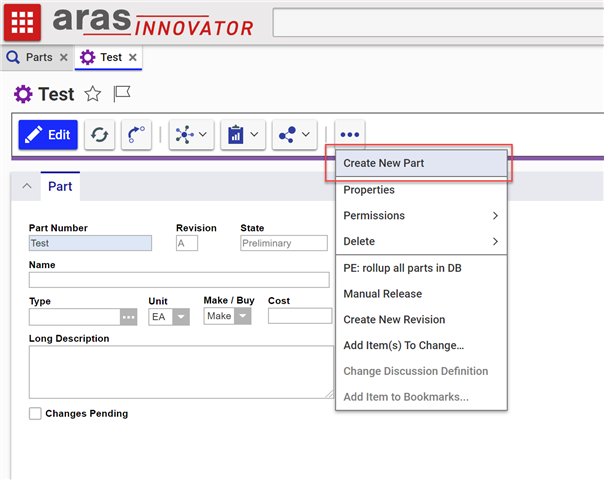

  3. Using a menu button in the item window
