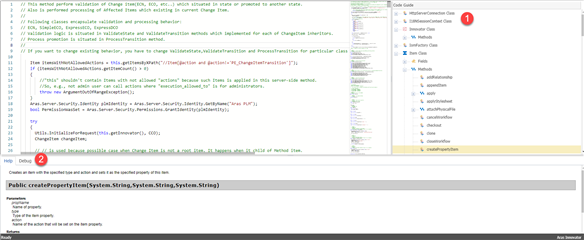

Notice that in this code snippet, we can set the sub-query of our created_by_id property in two different ways. Option 1 creates the item directly from the created_by_id property using createPropertyItem. Option 2 first creates the item and then appends it to the property using setPropertyItem. If you're following along with these samples in the Aras method editor, you can look at the right-side of the window to find a reference pane that you can use for quick lookups of IOM classes and functions. You can even double-click on a function in the reference pane to automatically paste it into your method code!
  1. The reference pane containing the names of the objects and methods available in the IOM
  2. The help pane that will be populated with a more detailed explanation of an object or method that you have selected
