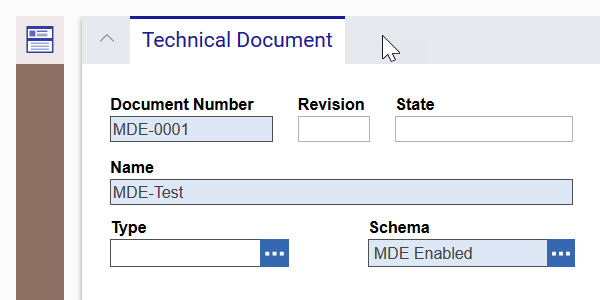

  3. Fill out the form’s required information:
    1. Document Number – ‘MDE-0001’
    2. Name – ‘MDE-Test’
    3. Schema – MDE Enabled
  4. Save (but don’t close) the new Tech Doc

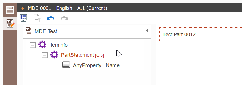

From the Editor tab, we can start adding elements to our Tech Doc.  Adding a Mapped Document Element is like adding any other Element to a Tech Doc, with some additional steps for selecting the specific Part. Just follow the steps below:

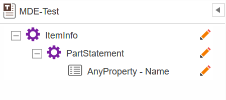

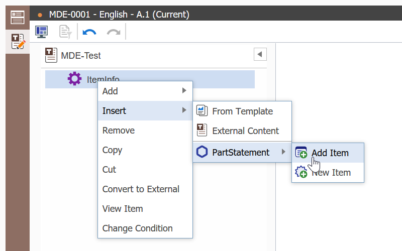

  1. Right click on the root element and select Insert > Item Info > Add Item.  In the dialog, search for and select the desired Item, then click OK
  2. Right click the ItemInfo entry in the tree and select Insert > PartStatement > Add Item.  In the dialog, search for and select the desired Item, then click OK
  3. Right click the PartStatement entry and select Insert > Any Property

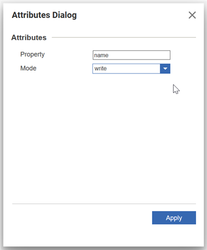

  4. Right click on the AnyProperty entry and select Edit Attributes to open a dialog
    1. In the property field, enter ‘name’
    2. Select ‘write’ for the mode
    3. Click apply
  5. Save (but don't close) the Tech Doc

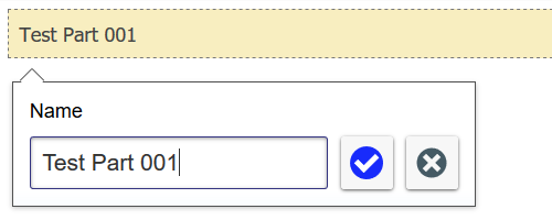

While the Tech Doc is claimed and in edit mode, you can double-click on the Property in the editor pane to open a pop-out field editor.  When selected, an MDE with write permissions will have a gray dashed border, while a read-only MDE will have a solid red border.  Changes made in that field can be added or discarded by clicking on the check or x boxes, respectively.  Once a change is made, the element in the tree and its parent element will be marked as changed with a pencil icon; clicking on that icon will open a dialog prompt to revert the changes.  To save any changes made to an Item, just click Save or Done.  On a save, any changes to Properties will be validated by the system.
Additionally, if changes have been made outside of the Tech Doc, the property in the editor will be highlighted with a red dashed border.  The right click menu on the PartStatement tree element will now contain a Version menu, which gives you option to update the data to reflect the latest version, ignore the current version, or ignore this and all new versions and changes.
