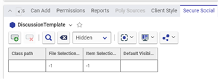

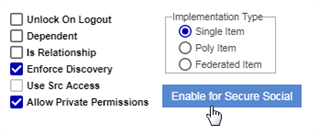

I’ll quickly show you how you can enable SSVC on a new ItemType. I’ll create a “Purchase Order” ItemType, to follow the examples we’ve been using in the Fundamentals blog series. Once you’ve created the ItemType, you’ll notice there is a button on the form labeled “Enable Secure Social”. Clicking this button will create a “Secure Social” relationship, which you can access using the tab of the same name. There should automatically be a row here once you’ve pressed the button, and there’s no need to modify it for now.
Navigate to the “Views” tab, and notice the checkbox towards the end of the grid. Here you are given the opportunity to include/exclude SSVC from each individual form associated with your ItemType. Go ahead and enable it for the relevant forms, before saving and closing the ItemType.

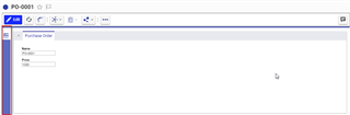

Now when we instantiate our new ItemType, we should notice that we have the Discussion button in the top right of our form, as well as a colored sidebar to the left of our form. This is where our discussion lives for our ItemType.
On the left side you’ll see a colored vertical bar. This bar houses the buttons which allow you to switch between different views based on items attached to the ItemType. The default viewers available to subscribers include CAD viewer, Document viewer, Image viewer, and a PDF viewer. These viewers will allow you to access viewables attached to the current ItemType through relationships.

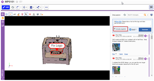

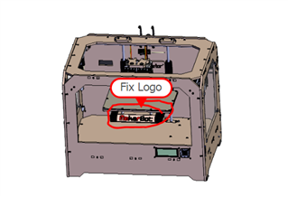

The final feature of SSVC which I’ll go over is the ability to mark up any of the viewables outlined in this blog. To show this off, I'll be looking at some Parts from a MakerBot 3D printer.  While looking at a viewable, pressing the pencil Icon will open up the markup tools, which allow you to annotate the viewable however you see fit. Once you’re finished, if you go to leave a comment there’s a checkbox labeled Include Snapshot. Enabling this option will insert an image of the marked up viewable into your comment.
