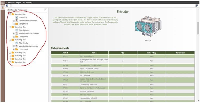

On the left of the TechDoc editor window, there’s an outline of all the elements of your document. Expand pieces of it until you have the elements that you want to move around. In our example, we’re going to move the whole of the Gantry section to between the Body and the Extruder.
To do this, all that needs done is to is left-click and hold on the Marketing-Doc section for the Gantry until it becomes translucent. From that point, it can be dragged up to where it’s wanted- you’ll see a horizontal bar showing exactly where it’s going to wind up, and the bar will be red if you can’t put it there for some reason. Blue means we’re good to go! Release the mouse button and it’ll drop into place.

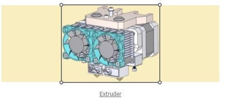

Looking at this, perhaps you want to adjust the size of your image. Make sure the TechDoc you want to edit is open for editing. If you find you can’t edit a section in a technical document in Aras Innovator, the reason is usually that you’re in a larger document that has another document linked within it. If that’s the case, you need to open the sub-document.  Once you're ready, left click on the image in the editor, and you’ll see a black outline appear around it with four circles at the corners. Simply click on one of the circles and drag it to resize the image. It will scale automatically for you.
Don’t forget to save and hit Done when you’re finished!
