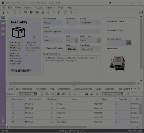

1. Custom Background Color
Custom Background Color for Non-Current Item
The first method in the import package, labs_StyleNonCurrent, changes the form background color to distinguish a non-current generation of an item from the current generation. Here's the method code to set the background color for non-current items:
gist.github.com/.../2e95b77597f0bfc0dc1f65bd3370d5cc

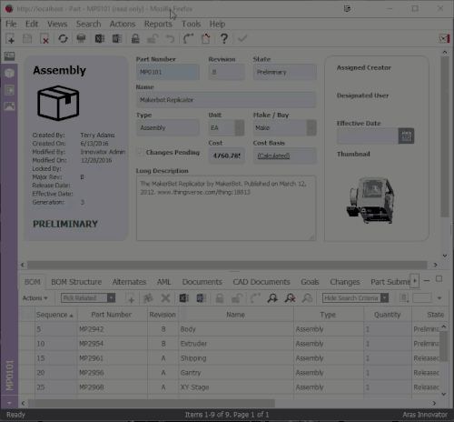

2. Watermark Image
Custom Watermark Image for Non-Current Item
The second method, labs_NonCurrentOverlay, displays a watermark image over the form when the context item is not the current generation. This approach requires a hidden HTML field on the form. If the context item is not current, the method code updates the CSS properties on the hidden field to make it visible.
gist.github.com/.../4b9b4d9ac026f6b791ee9d59ce1ed679
