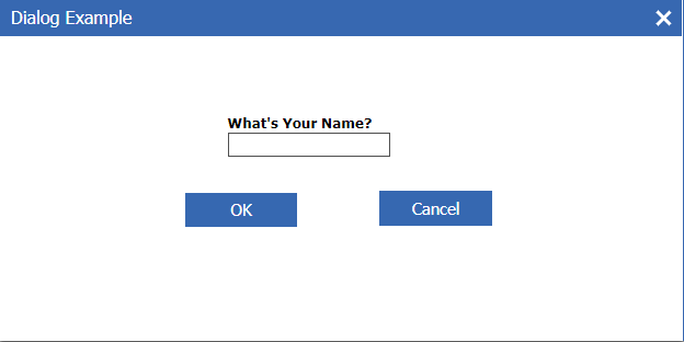

Opening a Form with a Dialog
One of the more common uses for dialogs is to open a custom form. In this example, we will be opening this simple form below in a number of different ways.

Returning a Value from a Modal Dialog
Before we open the dialog, we need to specify the functionality of the buttons on our form. Specifically, we want some way to return the name that a user enters into the textbox when a user clicks the OK button.
The onClick Field Event of the OK button on this form can be seen below.
gist.github.com/.../68bc1be2dd17e9281e40fc304bbcb3ee
The Cancel button simply calls window.close(); without setting a return value.

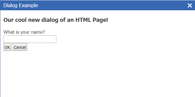

Opening an HTML Page with a Dialog
For this example, I have written a simple HTML page that looks similar to our form.
gist.github.com/.../78401065c73e2c42ae72bfe9d4e01150
I have named this "test_page.html" and have placed it into the /Client/customer/ folder of my code tree to separate it out from the standard installation of Aras Innovator 11.0 .
Now all we have to do is replace the content argument in our sample with this new HTML page.
gist.github.com/.../f6b0b02b45c95cf6d0a5cb4a81edc0f1
In this example, I have also added a "header" parameter that I am using to set the header of the resulting dialog. You can add any number of custom parameters and retrieve them from your custom HTML page using the dialogArguments object.
