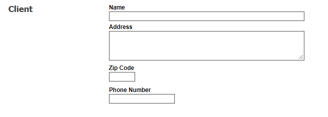

For simplicity, let's make all of these properties strings. We'll also allow Administrators to add new instances of this ItemType as well as see it on the TOC. Now select the new Client entry in the TOC and create a new Client. You should see a form like the one below.

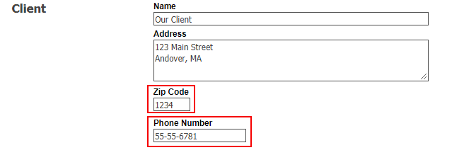

This is certainly usable enough to pass on to our users, but without verifying our data, we're introducing the risk for human error which could result in data like below.
The Zip Code only has 4 digits and the Phone Number only has 8.

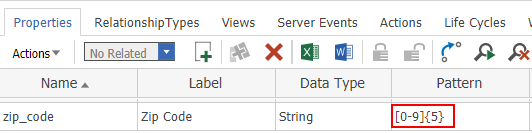

We want all of our zip codes to be exactly 5 characters. Each character should be a number between 0 and 9. With these rules, we can specify the Pattern of our Zip Code property to be the following Regular Expression: [0-9]{5}

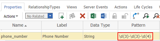

For simplicity in this example, we're going to make a few assumptions about the phone numbers we'll accept. All of our clients will have phone numbers from the United States of America. All phone numbers will include an area code and will follow the format XXX-XXX-XXXX. With these restrictions on our phone numbers, we can use the Regular Expression: d{3}-d{3}-d{4} . The d in this expression is shorthand for a digit between 0 and 9.
