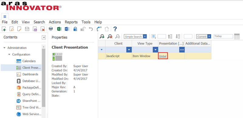

In this example, we will be disabling the Save As functionality for all of our users who are not members of the Administrators Identity. Just as in our previous blog posts, we will start out by opening the Global Presentation Configuration. This can be done by navigating to Administration > Configuration > Client Presentation and clicking the hyperlink highlighted below.

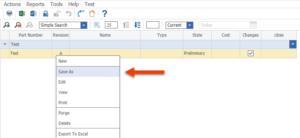

In the Command Bar Section relationship tab, you'll notice that each section handles the UI in different locations of Aras Innovator. The "Save As" button appears in three different locations in the UI.
- Main Window Main Menu
- The top-most menu that is available from the main grid.
- Main Window Toolbar
- The row of buttons immediately below the Main Menu
- Popup Menu for Item Grid
- The context menu viewable by right-clicking on an item in the main grid

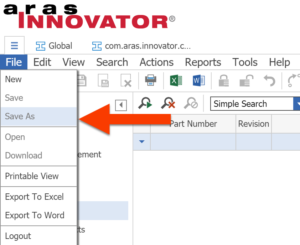

We'll first cover how to hide the Save As button from the Main Menu, but the steps will be very similar for each location.
- Search for the Command Bar Section responsible for this location in the Command Bar Section relationship tab
- Location - Main Window Main Menu
- Classification - Data Model
- There should be one result from this search. Open it
- In the Command Bar Item relationship tab, search for the following
- Name - *save*as*
- Note: Depending on the Location, this Command Bar Item may either be a Menu, Button, or Menu Button
- Set the value of the For Identity [...] field to Administrators
- Save, Unlock, and Close the Command Bar Section
Following those steps, the Save As button the Main Menu should be hidden the next time that a non-administrator user logs in. For the Main Window Toolbar and the Popup Menu, you will simply repeat the same steps as above, but search for the appropriate location in Step 1.
