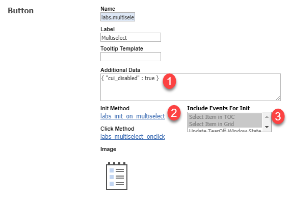

The steps for adding this button will be mostly similar to those for adding the custom refresh button with a few key differences. Instead of adding this to the Tearoff Window Toolbar, we'll be adding this button to the Main Window Toolbar so that it will be available from the main grid. We'll also be setting a few more properties on this button as seen in the screenshot below.
  1. Additional Data - By passing in { "cui_disabled" : true }, the button will be disabled by default.
  2. Init Method - This method will determine when this button is enabled.
  3. Include Events For Init - This will determine when the Init Method for this button is called. Here we want it to be called whenever an item is selected in the grid, so we can check if at least two items are selected.
