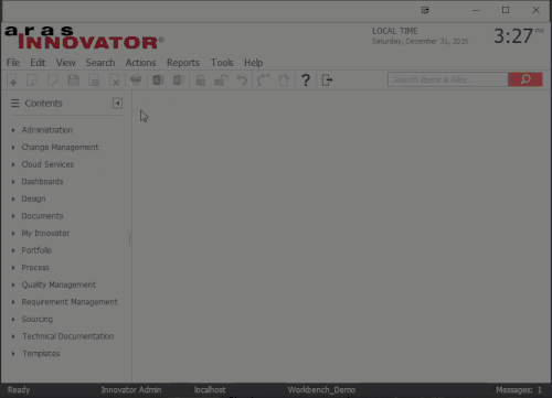

Calling Date Dialog From Method Code
The project's import package contains a Javascript method - labs_CallDateDialog. This method calls a datepicker dialog and then executes a custom callback function with the selected date as a parameter. The callback function in this sample code simply displays the date parameter in a browser alert, but you could use the same approach to perform some other business logic with the selected date.
