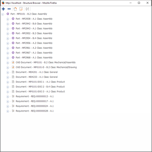

Display the classification property for Part items

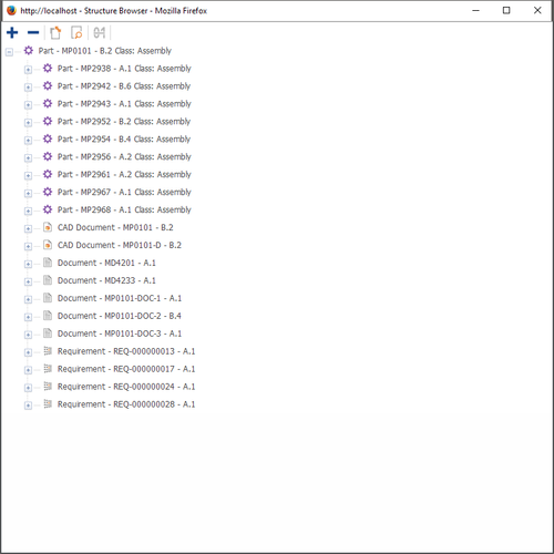

In this example, we will be adding the classification property to the context item and all items of the same type. As you can see in the screenshot above, the selected Part and all of its related Part items include their classification values. The other ItemTypes - CAD Document, Document, and Requirement do not display classification values.
The following C# method code is an excerpt from the customized GetItemsForStructureBrowser method import. You can find the complete package in the Override Default Structure Browser project: 2 - Add Property For Context Item.
