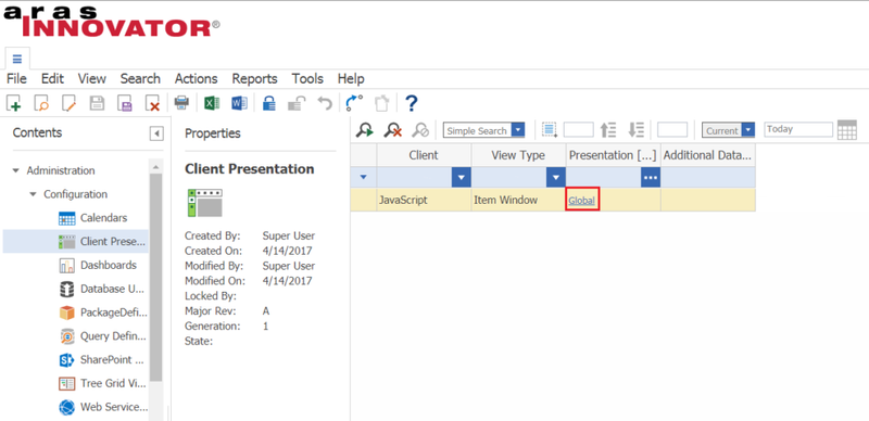

  1. In the TOC, navigate to Administration > Configuration > Client Presentation and click the hyperlink highlighted below

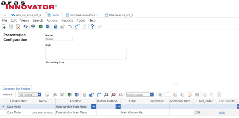

  2. In the Command Bar Section relationship tab, search for the item below
    • Classification: Data Model
    • Name: com.aras.innovator.cui_default.main_window_main_menu
    • Location: Main Window Main Menu
  3. Open and lock this item

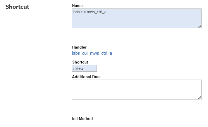

  5. Right-click > View "Command Bar Item" to view this shortcut in a new window
  6. Fill in the following information
    • Handler: my_mws_ctrl_a
    • Shortcut: ctrl+a
  7. Save, unlock, and close this Shortcut
  8. Save, unlock, and close the Command Bar Section
