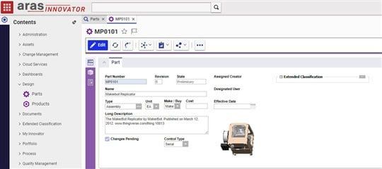

These next two commands will open a search grid, and then search up and open a particular item from that grid. We’ll use Parts and an item called MP0101, but spell out how to change these commands to look for whatever item you have in your configuration.
//Open a search grid from toc
Actor.AttemptsTo(Open.SearchPanel.OfTocItemWithPath("Design/Part").BySecondaryMenu);
//Open an item from the search grid
Actor.AttemptsTo(Open.Item.InMainGrid.WithValueInCell("Part Number", "MP0101").ByContextMenu);
When opening the search grid, you need to enter the whole path to the item you want. In our example, Part is under Design, so we use “Design/Part” to find it. When searching for a particular item, you need both the property you want to search on, and the value of the item you want. Important note: You use the label of the property, not the name of the property. “Part Number” for example is the label of the property named “item_number” but you can’t feed “item_number” into this command. Both commands require you to be using Aras.TAF.ArasInnovator12.Actions.Chains.OpenChains.
