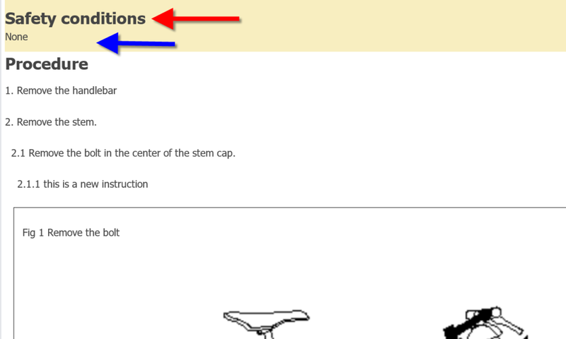

Working on some new complex technical documentation schemas, I needed to have predefined section titles. Here is the piece of document I wanted to have:
  • The blue arrow shows where I want to actually type information
  • The red arrow shows a static text that I want by default whenever I add a Safety Conditions text.
In my technical document schema, the Safety Conditions element is a text element. But I don't want to type "Safety Conditions". This has to be some kind of title for what I will put inside, whether it contains text or a more complex data structure.
It is quite simple to do that because CSS provides us with this capability.
gist.github.com/.../8f10d67188fead5667b1a168d75aa2a0
In the first image, "None" is actually the text that I typed within my Tech Doc editor window and "Safety conditions" has been added because of the CSS.
A few explanations about the CSS:
  • The content value is what will appear.
  • We added "A" in combination with " white-space: pre
  • The rest of the css is for text formating and only applies to this specific text, not for the text you will type.
