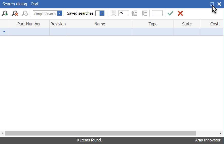

One of the most common of these is the SearchDialog which allows a user to search for, select, and return one or more Items. In the example below, I am opening a SearchDialog on the Part ItemType and printing out the item number of any part selected.
gist.github.com/.../558bcaf6046834e2afc02b8f848519c6
This sample also demonstrates the MaximazableDialog (with that spelling). There is no functional difference between this and a regular dialog except for an additional button in the toolbar that will expand the dialog to the dimensions of the parent window.
