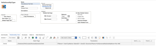

Using this Action in a Relationship Tab
The Related Parts relationship tab on the Manufacturer Part ItemType is actually a bit of misnomer in that it displays any parent Parts that have a relationship to that Manufacturer Part. This relationship tab uses a special view that's powered by the PE_GetRelatedParts action, and you can use this view for your own relationships as well.
If we login as an administrator and navigate to TOC > Administration > RelationshipTypes, we can open the Manufacturer Part Part relationship. Here, we can see that a special view has been set in the Relationship View tab. This will override the default relationship grid with whatever alternate view you specify here.
We can see that this view is pointing to a file called ReverseItemsGrid.html. If you look inside this file, you'll see it's a specially formatted grid that's populated by a query using PE_GetRelatedParts. The Parameters field represents the arguments that will be used to run the query.
'ITName='+itemTypeName+'&itemID='+itemID+'&reverseITName=Part&reverseRelationshipName=Part AML'
