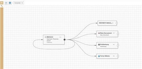

A basic example might be if you want a sidebar to be visible for all items. Not many visualizations will apply to every item, but one such example might be displaying the ad hoc graph--a graph showing the ItemTypes which relate to this item. We want this to be available from every item, and we want it to show in the center of the screen.

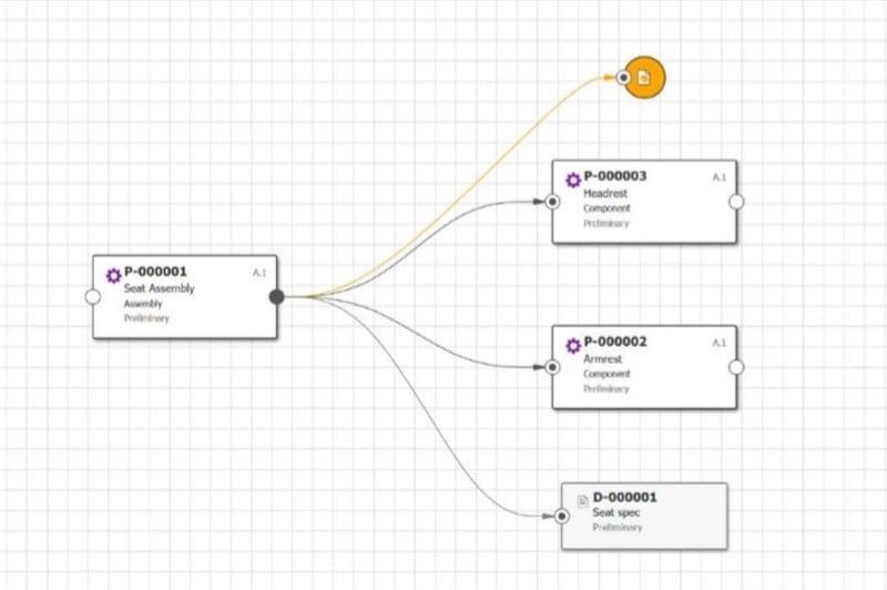

You may find that you want to be more selective. Rather than having a sidebar option always available, you may want it to be present only on items of a certain ItemType. For example, perhaps you want to show the Part BOM Graph from a sidebar option on Parts. There’s no reason to make this apply to all items everywhere- most of them don’t have Part BOM relationships.
